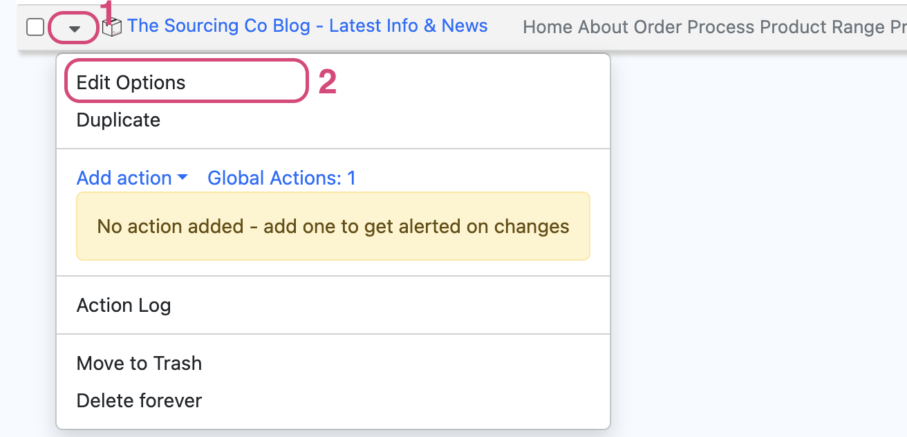

You can navigate to the config of a monitor from the Options window. Here are the steps to view the config:
  1. Click on the down caret icon for a Monitor to view quick action items.
  2. Click on Edit Options. This opens the Options window.
    Edit Options
