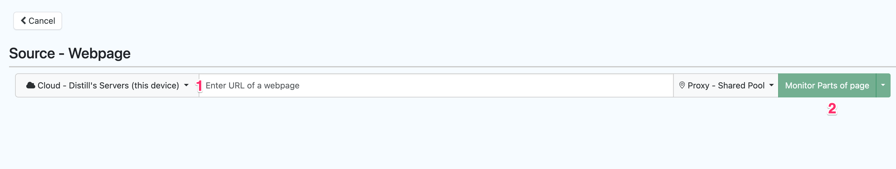

  3. If you have chosen Web Page as your monitor type, the source page opens. Paste the URL of the webpage you want to monitor. To monitor specific sections, click Monitor Parts of Page. To monitor the entire webpage, click the down caret next to the “Monitor Parts of Page” button and select Full Page.

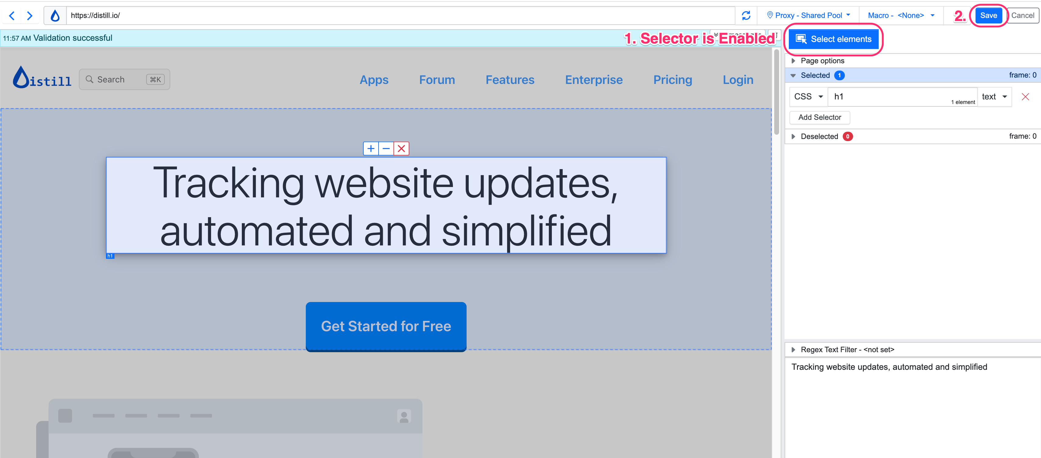

  1. The Visual selector opens. When the “Select Elements” button is blue, it means you are in selection mode. In selection mode, any clicks on the webpage will select elements instead of interacting with the page normally. Hover your mouse around the section on the page that you want to monitor. Once you select your desired content, click the Save button.
Visual selector view in Web App
You can make multiple selections if you want to monitor different parts of the page.
Use the Expand, Contract, and Delete options to modify the size of the selected area. Read more about how to use the Visual selector here.
