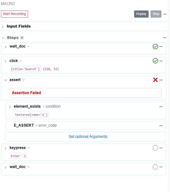

E_ASSERT
This error is triggered when a custom assertion condition fails during macro/scraper execution.
  • It means a step in your recorder expected something to be true, but that condition wasn’t met.
  • The expected element or content is missing
  • The page loaded differently than expected
  • The assertion logic needs updating
To fix:
  • Open the assert step in the recorder
  • Review the condition (e.g. element_exists(html))
  • Adjust or remove the assertion if it no longer applies
  • Replay the recorder to test if the step passes

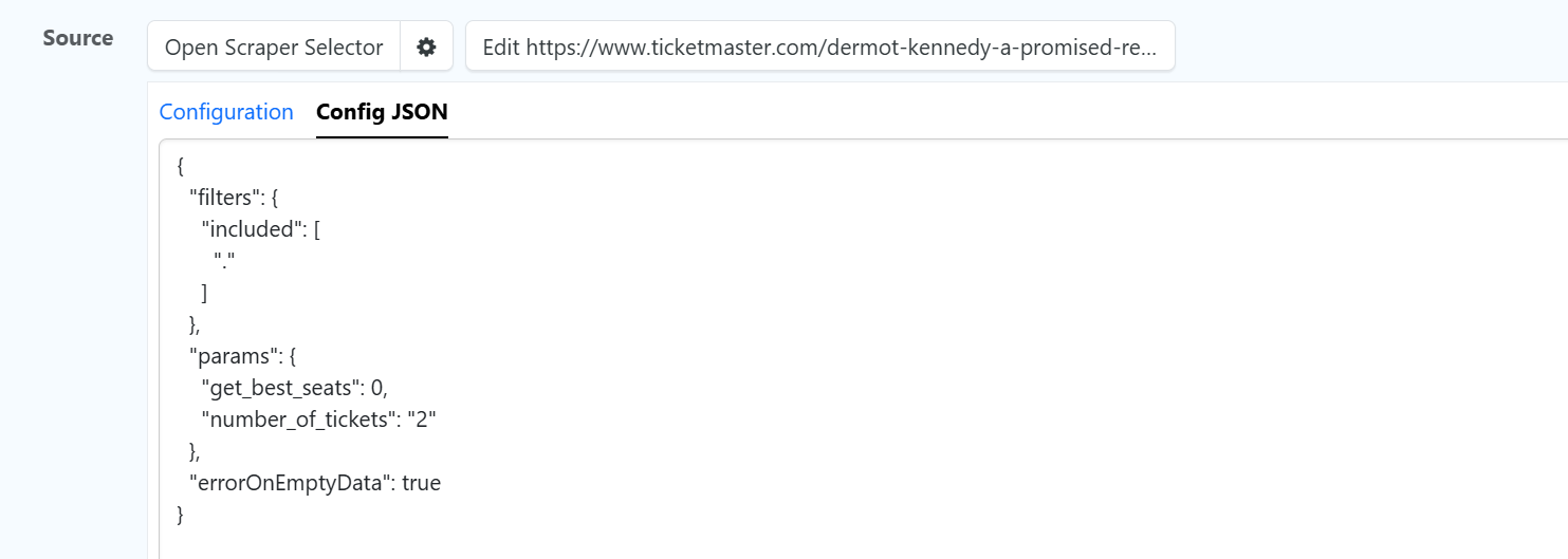

E_CONFIG
E_CONFIG is a monitor configuration error. It is logged when the monitor configuration is invalid. Here are some of the common reasons for this error:
  • The monitor configuration is malformed or isn’t a valid JSON.
  • The monitor’s URL is either empty or invalid.
  • For webpage monitors, when the monitor’s selector type is invalid. We support XPATH, CSS, and JS selectors. supported-selector-types.png

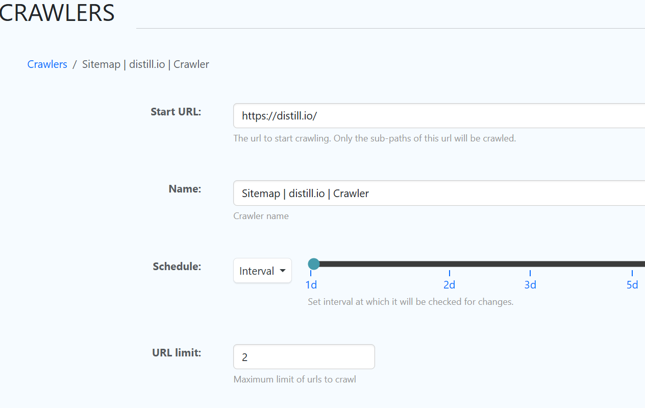

E_CRAWL_URL_LIMIT_EXCEEDED
This error occurs in Sitemap monitors when the crawler exceeds the set URL limit, usually because the limit is too low for the number of links found. The URL limit setting restricts how many URLs the crawler can visit. If the actual number of URLs discovered during crawling exceeds this limit, the monitor throws this error.
Increase the URL limit from either of the following places:
  • View Crawler: Open the monitor, go to the crawler settings, and update the URL limit field.
  • Watchlist Topbar → Crawlers Option: Open the relevant crawler and update the URL limit directly. crawl-url-limit.png

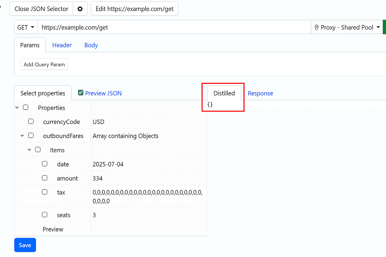

E_FIELDS_NOT_FOUND
This error occurs when no fields are selected in the JSON Selector panel.
  • Select at least one property from the left panel under Select properties
  • If nothing is selected, the distilled response will be empty {}

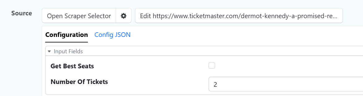

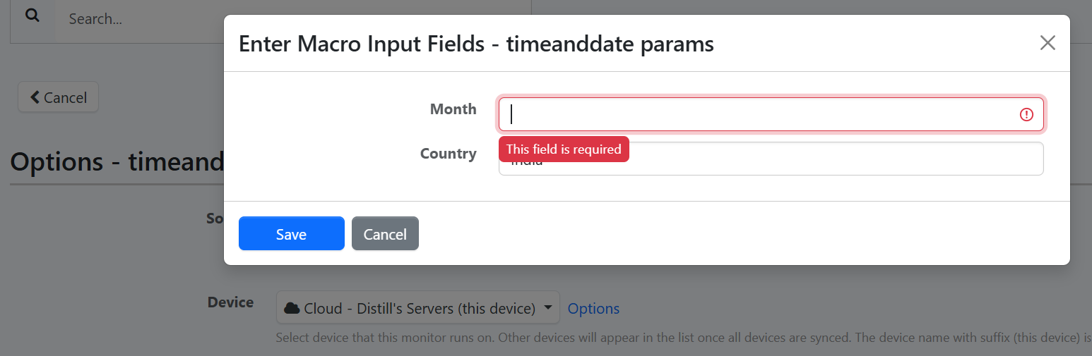

E_MISSING_INPUT
Required macro input field is empty.
  • Make sure all required fields are filled in the macro’s Input Fields in the options page.
  • Check for any missing parameters.
  • Verify input field names and values are correct.

  • This can happen when a required field is empty or missing
  • For user-created scrapers, check the Validators section in the Recorder and make sure the rules match the expected data format
  • If using a managed scraper, contact support for help
